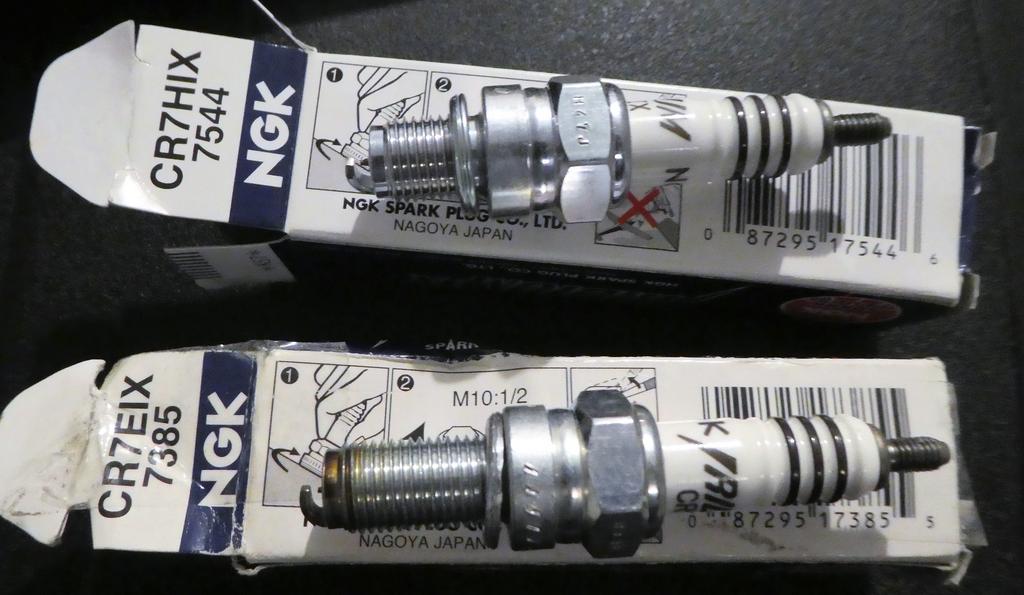

Think I just installed the wrong plug on 2012 200i . . . installed NGK CR7EIX . . . . but on reflection, it looked significantly longer in the thread area than the stock OEM plug.  Do I need to replace this with CR7HIX?  Or am I safe?  Do not want to restart engine before being sure . . . but do not want to have to redo the job if not necessary. . . .

Yes, do not start your engine with the CR7EIX in the LIKE200i.
I have no idea what will happen. Maybe nothing....
Years ago I investigated which Iridium Denso and NGK was a direct replacement for the normal plug.
My studies showed that the CR7HIX was the correct plug - and I have been using it in my LIKE200i for 6 years with good results.
BTW - found the NGK Iridium to work better than the Denso Iridium - so took the Denso back out. Again - I forget why I preferred the NGK.....6 years ago.
The used EIX plug seen here was used in another scooter (Forza or Burgman - forget which)

Thanks for the clairification Stig. I did not start engine with EIX in it. Got an HIX instead, installed, gapped valves, changed oil, gear oil, and took it out on the road. All is good.  I will wait on changing the tires until these have some wear on them.  But if they are "hard" tires, I am thinking of running them with -5 PSI for a somewhat softer ride and more contact with road.  ??
