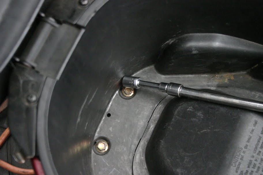

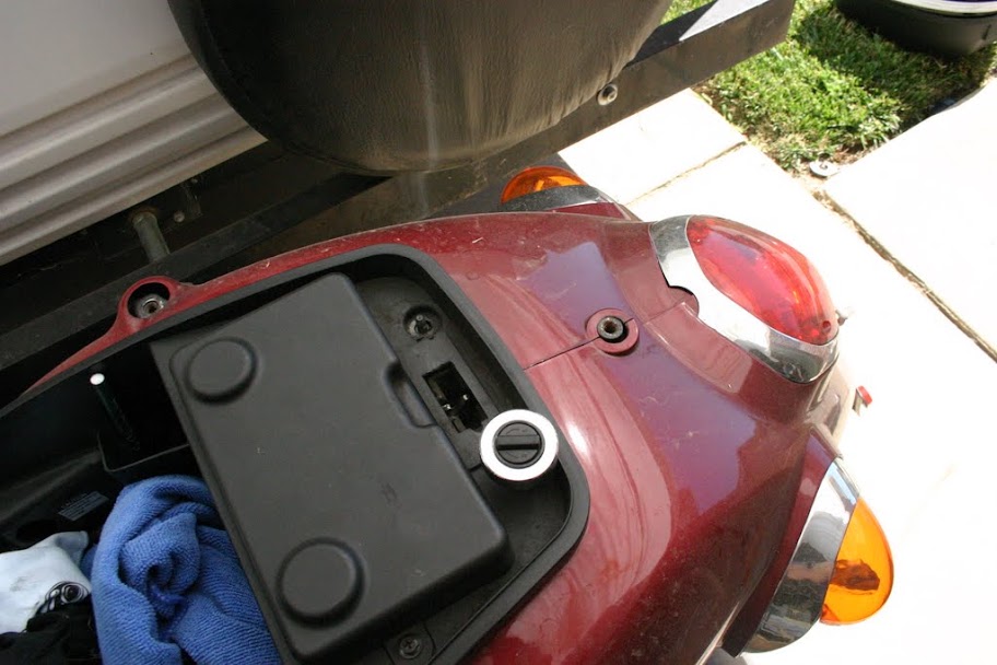

You could take the whole bucket out with four bolts. if the p150 is like the P250, there are two behind the battery cover and two at the bottom, near the front edge. the seat stays attached.. These the photos for my P250. I changed the bolts behind the battery so they are the same size as the other ones (10MM)
