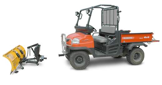

Meyer makes a plow that mounts to a 2" front receiver, but I would beef up the suspension
https://www.meyerproducts.com/snow-plows/off-road/utility-vehicle-snow-plow?utm_source=text ads&utm_medium=cpc&utm_campaign=UTV Plows
what is odd is even though they picture a utv with a plow, when you try to configure a plow, their configuration tool  comes back with this "Sorry, there are no recommended plows for this vehicle"
