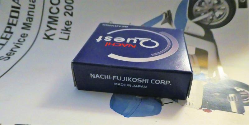

I purchased a Japanese made NACHI bearing which I will install in the fork when I do my rear tire and brake R&R in a few days.
I've used this brand of bearing with good success on my Burgman....here in the CVT cover. It helps support things back there, and is an easy installation.

The Nachi bearing I used was very nice Japanese quality for less than the Kymco part. Fits and working great for 2 yrs now.
